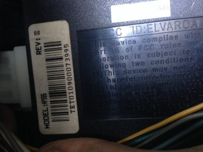

My truck has after market electric start and security, The remote broke on me and the module doesnt have a name on it. should i just take it to an electric start and security installer or is there a way to find out what the hell the system is by myself?

There's no name on the module?? There has to be some #'s somewhere, if you can get those I can see what I can dig up.

I can get you the model number, pretty sure i saw that on there.

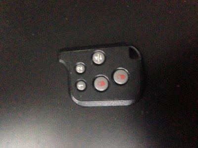

This is the remote that came with my truck
Well, that one looks pretty aged. There's quite a few models of systems by Prestige that are discontinued with yours being one of them. I would say your best bet is to get a new "better" system.

hmm, Guess i could get a viper system

It just sucks that it was working great and it seems to have unprogrammed itself. The light on the fob still works its just not sending commands anymore

No functions, Is there a way to program these things just to try before i spend a nice chunk of cash
