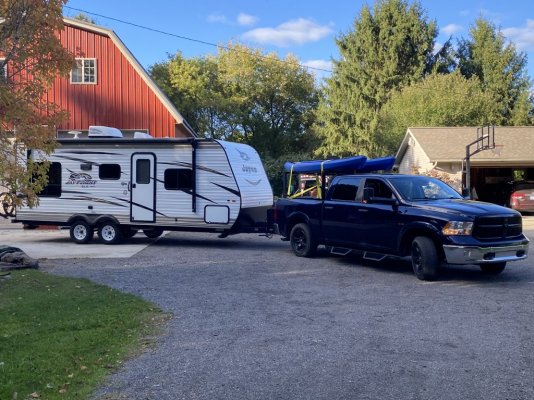

My dad put one on his 24’ travel trailer, works great so far and definitely makes hitching up a lot easier, especially with sway bars having to go up and down twice. Just recommend keeping a bucket or bag over the jack to keep it out of the elements.2CE2B15E-5ED0-430E-BD38-66A5CB520995.jpeg
