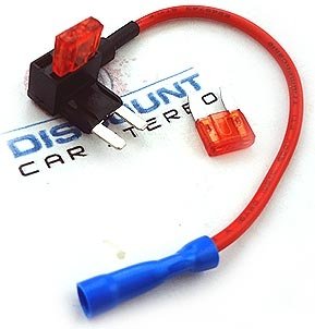

Empty slots I noticed didn't have any contact pins in them. Other problem is with those piggybacks shown above. Do they make those in the size of the fuses in the box? I don't think any of them are the "normal" size they are all tiny, like 1/4" or so wide
