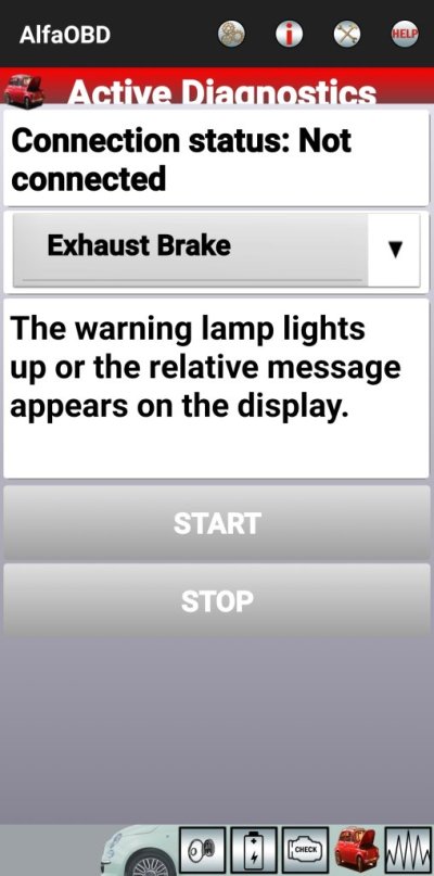

Hello everyone. I have a question regarding alfaobd and 5th gen 2020 3500. I've been trying to find out of you can use alfaobd to program your truck so that the engine brake is always on. My guess is this is not an available feature, because I've had no luck when searching this feature.

I've attached some screen shots of what I've found in the alfaobd app. I think this only changes the instrument cluster message?

What you are selecting in that menu is to TEST and illuminate the exhaust brake so it will come on and show on the cluster.
What you're asking to do is On initial startup to have the exhaust brake ON automatically instead of having to hit the button every time.
I've tried and never heard of anyone being able to do it with AlfaOBD. There is an aftermarket company that offers a module that plugs into the OBDII Port and gives you features including that. But I can't remember the name right now and it cost a few hundred bucks.

I haven't tried the app yet. I was just scrolling around to try and find that option. On at start up without pressing the button. By the description I saw it is an instrument option.
