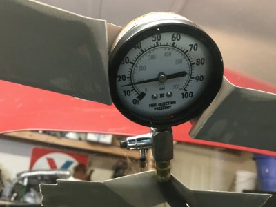

Throw a fuel pressure gauge on it. See if it’s fuel related. Could be a TIPM issue too. And crank sensor
