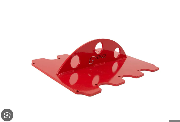

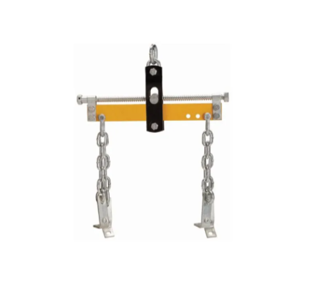

But, I think If I were doing what you are doing, i'd overcomplicate and overengineer it. Instead of just having different mounting holes to adjust balance, I would add something to make it compatible with a leveller
The Harbor Freight screw type leveling thing:

Those on the top do not make me feel comfortable, those so called bolts just leave a lot to be desired.
Those on the bottom look like they are very capable.

That one that uses the 10 intake bolts kinda scares me. I'd like to use the bolts at the front and back of the heads.
Agree 1000% with me over-engineering it, except in my case I would be over-complicating it.....lol

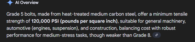

A cheap, grade5, 6mm diameter bolt has about .044 square inches of area in section, and the tensile strength of a grade 5 bolt material is about 120,000psi:
So, a single 6mm grade 5 bolt with .044 square inches of area in shear can take 5260lbs of force before it yeilds in tension. Multiply x the number of bolts.

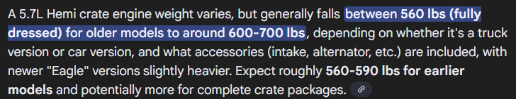

A Hemi weights about 700lbs:
I don't think the weight of the engine would be a concern with either of the lifting tools above. The engineers who designed those left alot of margin for safety.
Yes, those bolts are kind of puny. I agree with bolts front and back, it just makes more sense.

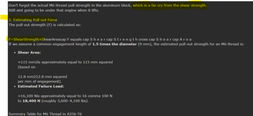

Don't forget the actual M6 thread pull strength in the aluminum block, which is a far cry from the shear strength.
Still aint going to be under that engine when it lifts.
3. Estimating Pull-out Force
The pull-out strength (F) is calculated as:
F=ShearStrength×ShearAreacap F equals cap S h e a r cap S t r e n g t h cross cap S h e a r cap A r e a
If we assume a common engagement length of 1.5 times the diameter (9 mm), the estimated pull-out strength for an M6 thread is:
  • Shear Area:
    ≈115 mm2is approximately equal to 115 mm squared
    (based on
    12.8 mm212.8 mm squared
    per mm of engagement).
  • Estimated Failure Load:
    ≈16,100 Nis approximately equal to 16 comma 100 N
    to 18,400 N (roughly 3,600–4,100 lbs).
Summary Table for M6 Thread in A356-T6
Engagement Depth Estimated Pull-out Force (kN)Estimated Pull-out Force (lbs)
1.0 x Dia (6 mm)10.8 – 12.3 kN2,400 – 2,750 lbs
1.5 x Dia (9 mm)16.2 – 18.5 kN3,650 – 4,150 lbs
2.0 x Dia (12 mm)21.6 – 24.6 kN4,850 – 5,500 lbs
Note: For structural applications, a safety factor (typically 2x to 4x) should be applied. If the bolt is made of high-strength steel (e.g., Grade 8.8 or 10.9), the aluminum threads will almost always be the point of failure unless the engagement length is significantly increased (e.g., >2.0D). For further technical data, you can consult the MatWeb A356-T6 Property Sheet.

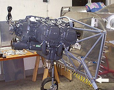

You all that are worried about the bolts pulling out on that lifting plate, Don't ever look at the 4 or 6 little bolts for the engine mount on a fixed wing aircraft that supports the entire engine hanging out in front off the firewall.
Engagement DepthEstimated Pull-out Force (kN)Estimated Pull-out Force (lbs)
From your post:
So, yea the pull out strength IS the shear strength x the area in shear.
So, from the chart you posted. If the pullout force is 4850 -5500 lbs per bolt, and there are 10 bolts
and the Hemi weighs 700 lbs
The conservative estimate, using your own data, would be 4850lbs per bolt x 10 bolts = 48,500 lbs before the bolts would pull out.
Since a Hemi weighs 700lbs on the high end of the estimates, the safety margin here is about 69X
Neither would anyone else with any common sense, regardless of how strong the bolts are.
