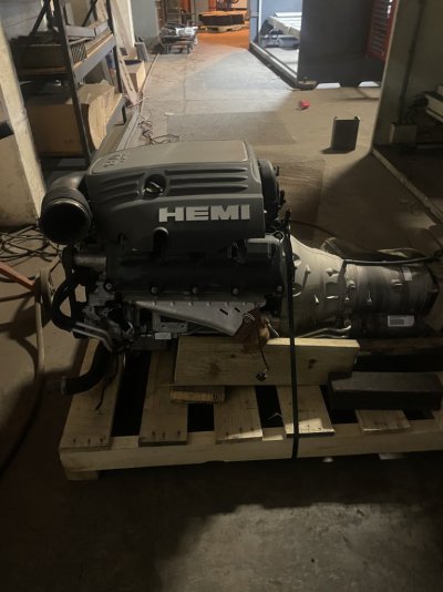

So, it finally happened this morning. Got real bad tick on the way into work. I am so glad I bought this replacement engine.
So just to be clear I should be good to go for the swap. From reading all the post I will need to use the original engines FRONT TIMING COVER, OIL PAN, OIL PICK UP TUBE, INTAKE MANIFOLD, DIP STICK TUBE, and ALL ORIGINAL SENSORS. Also, possibly the PILOT BUSHING in the end of the crank to match the trucks torque convertor. I may just buy all these parts new that way I can just rebuild the original engine for a swap if this one ever goes bad. Only I would delete the AFM/DOD fuel Managment system. Can anyone please take a look and make sure I am not missing anything. I would greatly appreciate it. I forgot to mention also the buy I bought the extra engine only wanted and extra $250 bucks for the Chargers transmission too I ended up with that also. Later down the line I will swap that too. Fill that be an issue. Will it swap in?
Dodge calls it MDS,not AFM/DOD,that's a GM thing. To properly delete the MDS system,you need to swap the cam,and the 8 MDS lifters,then pull the mds solenoids and replace them with Ma Mopars mds block off plugs for a 6 speed 5.7 or 6.4 Challenger,then have it tuned
By the looks of your avatar,your truck is a 4X4,if that's the case the cars 8 speed won't work,as it's not set up to bolt a transfer case to,you'll need a 4X4 truck 8 speed.
If your trucks a 2X4,with some cooler line adapting,you can make the cars 8 speed work

Yes, it's a 4x4. So, looks like I can't use it. Maybe I can sell it and get something back for it. Thanks for the heads up!
