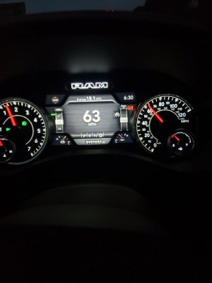

My EPS has failed while driving and the steering wheel is hard to turn. Then it starts to work again and when it does you over correct and are all over the road. It is a in and out thing not constant. Am I the first person to have this on the 2019 @10000 miles. Dropped off at dealer this morning and waiting to see what they say.
