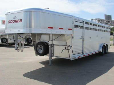

We use to pull a trailer similar to this it was a 38ft sooner with the rounded nose like in the pic with my dad's f-250 shortbed and never had any issues it never even got close to the cab. There was a racing buddy that was pulling a standered enclosed trailer and he popped his rear glass but he got him self in a bad spot backing up and I believe he was turned so hard he got his bedside also. But if you have a v nose and pay attention 3 Times a year I bet you'll be just fine.
