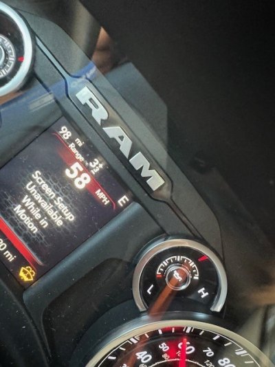

Good morning everyone. I have a weird error and the truck is driving weird. the error is a number 3 then +3-. Can anyone look at the picture and let me know what you think it could be?

Did you hit the gear range buttons? It's telling you you're in third gear and you're limited to third gear.

I have a V6 and no 4wd. I dont think i have that button, but i am going to look no wfor sure!

They would be on the steering wheel, and they are marked "gear limit".
