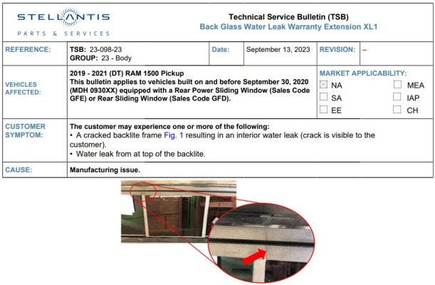

Did you read the TSB called backlite.pdf?
DIAGNOSIS: If the customer describes any of the symptoms listed above in the customer symptom section, perform the Repair Procedure.
Updated;
I know this is small potatoes compared to the cost of a new battery but if FCA are accepting the window as a manufacturing defect, how can they deny other damages as a result of this same window failure?
I'm quite aware of FCA's selective acceptance of liability but, one step at a time. I see this as more ammunition for your cause which can hopefully be resolved with diplomacy rather than legal action.
Regardless, we still need to build the case with info like this.

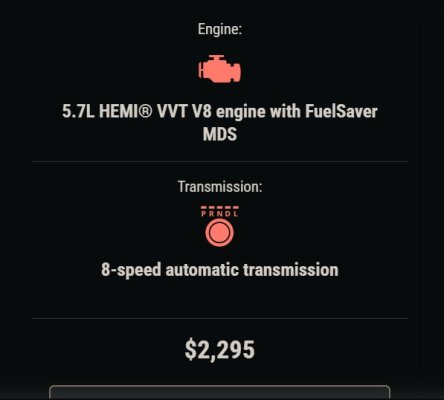

I went to the dealer about four weeks ago. It is impossible to order a RAM 1500 5.7 without that generator/starter/ 48 volt battery system. What a stupid mistake RAM has taken. I will keep mine and run it till it gives out, rebuild it and keep going!
That's odd!
I can still build a 2024 1500 Bighorn with a regular 5.7 on the Canadian Ram site.
