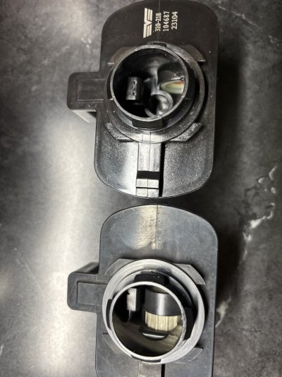

Are you still dealing with the 0456, 0457 codes and gas cap error? I just solved the same issue on my 2015 6.4L. It was the Evap Leak Detection Valve on the canister. Tried 3 different Dorman units (Part number 310-218) and while they all cleared the codes, I then couldn't get gas in the tank without the pump shutting off. Put in a Duralast valve (Pat number ESM1000) and that solved both problems.
The Dorman valve is a completely different design internally than the OEM and Duralast version. Not sure if that contributed to the problem. Dorman part on top, Duralast on bottom.
