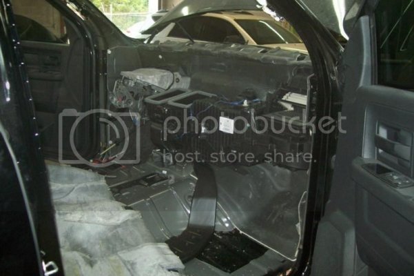

Given your light repair work, I would not attempt to pull the dash.
You will be working in an area with an airbag and the steering column will have to be dropped from its position. Pulling the seats will make the job easier. Years (to many) ago as a mechanic I had done a few but personally would not do it now. It is an all day job for an experienced mechanic, so unless you have time and someone that might be able to help you I would consider paying the grand.
000_0031_zps862b07b5.jpg"]000_0031_zps862b07b5.jpg[/URL]
