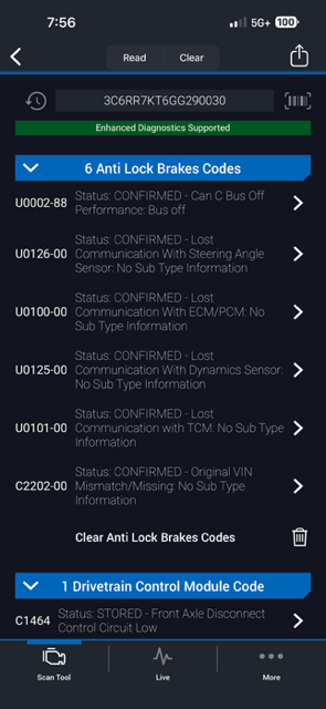

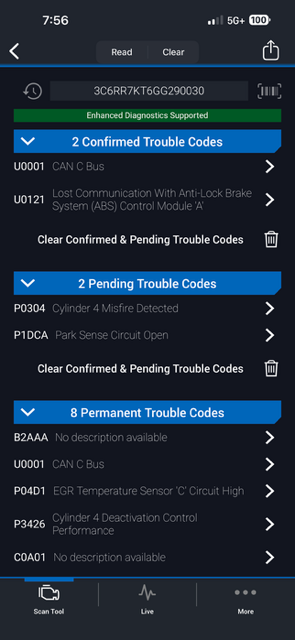

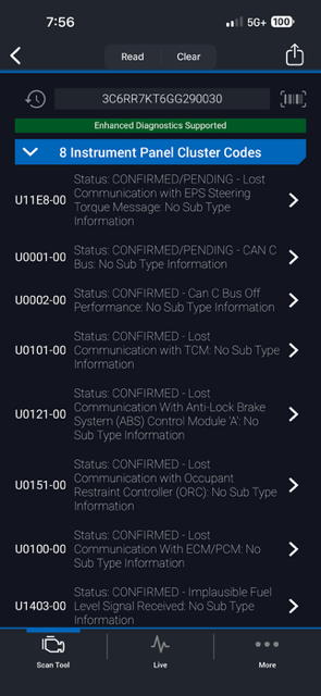

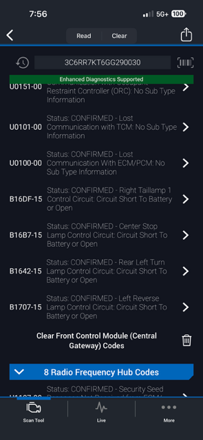

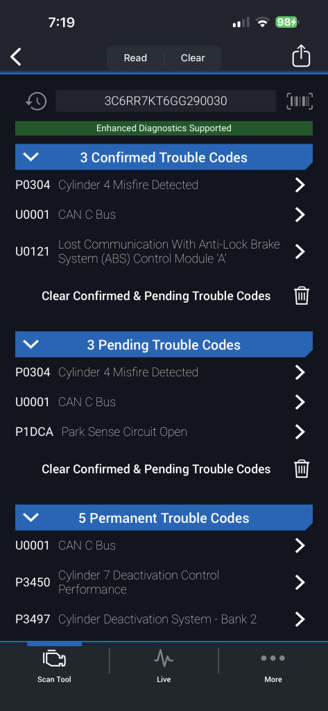

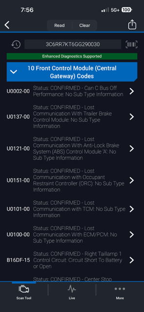

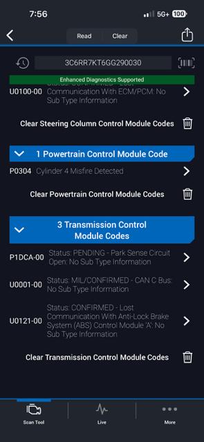

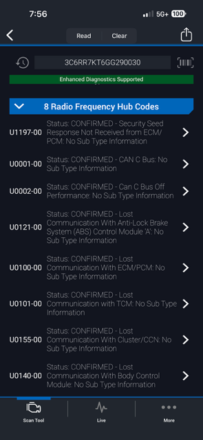

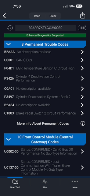

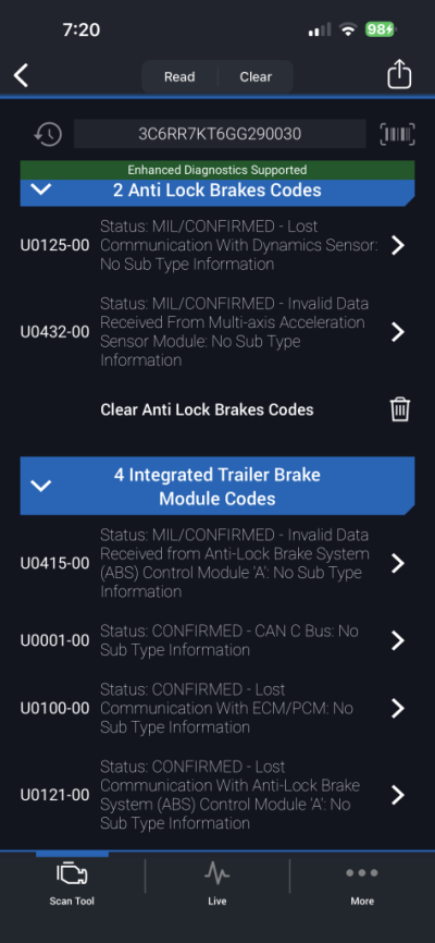

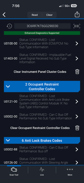

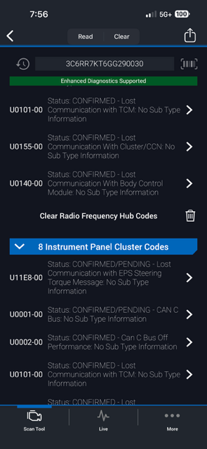

I want to first THANK YOU for your help. I have not checked the grounds or the fuse box yet. I my list for today.
I was able to put a code reader on and get some codes. It reads like War & Peace in terms of pages. They are attached. Maybe this helps, or tells you to tell me to burn the truck
Again, I thank you for all your input

Okay, you have them all captured which is good. Still looks like the system was way low on voltage and set a ton of codes due to communication errors. Clear all the error codes and lets see what comes back but do not restart until you have done the fuses and grounds..
