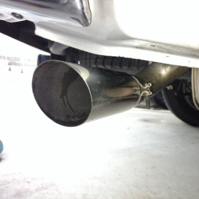

I really want these style exhaust tips for me beast ! I currently have n mbrp exhaust with the included tips my question is is there exhaust adapters to fill the gap between the mbrp tail pipe to accommodate the 4” inlet of these? Any ideas ?

What is the size of the pipe you have? They make reducers for all sized with out having to get custom

I believe 3”

$200 each and a setscrew holds them on?
Look closer, it uses a built in clamp w/split pipe similar to an exhaust seal clamp to hold onto the exhaust pipe.

Just search on eBay. Going to run about $20
https://www.ebay.com/itm/172681170438
He'll need to cut a slot on the inlet side with a cut off wheel and use an exhaust seal clamp to hold it on. (or have the adapters welded on).
I found a stainless exhaust tip I liked but it was weld on only, I used the above to attach it to my exhaust.

To keep it clean, I would look at making the 3- inch to 4 inch conversion at the muffler, then there is not a 3 inch pipe to 4 inch adapter to 5 inch tip all in the same area.
