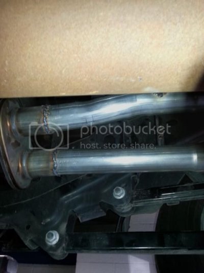

I got my muffler installed over the weekend. I paid 127 and some change to have it shipped to the house. I bought 3 clamps and two 18" sections of 2.25" pipe which I cut to the needed size which altogether cost a little less than $30.
I went to my uncle's shop since he had a lift and we were able to get the OEM muffler removed pretty easily. The hardest part was getting the rubber keepers off of the hangers. The exit pipes didn't line up exactly right, but there was enough play in the pipes that we could weld them and have the exhaust pipes end up where they were they needed to be. Clamped the muffler and then welded the extra section to the existing section and voila!
It took about 30 minutes altogether which wasn't bad at all.
