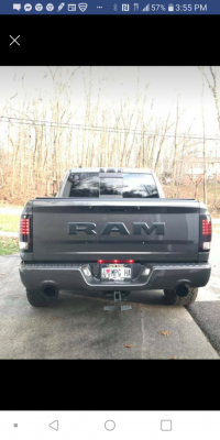

may sound weird, but stock tips? I added Moe's 5" tips, even on a stock muffler, made it deeper.

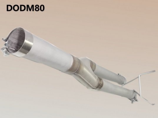

Mufflex DODM80 with Moe's 5" Tips
Sounds like !!!!! Murica !!!!!

Hmm for DODM80 lot of highway drone? I’d be able to maintain Mopar performance exhaust? Have to cut muffler out?

Looks like comparing the two shows the Mopar one has piped attached running up from the muffler to the pipes and the mufflex does not so I’d have to buy pipes and more clamping or cut the Mopar muffler it seems like...hmmm...

Here's a picture of stock vs mopar. You'd need pipes and other things like you're thinking as the stock exhaust disconnects right at the muffler.
full
wonder if there’s anything even different between the Mopar muffler and the stock ram muffler anyway.

You guys really got me turned on to the DODM80!!!
Anyone ever made that work with Mopar cat back?? Really wanna make that work somehow.
Was debating black tips which maybe would be easier and more cost effective than the pipe route as well to compliment the blue and black theme I got going on..what do you guys think? So stupid considering I bought this truck with the Mopar for a reason and here we go again removing everything

Maybe I could see if muffler shop could straight pipe it (same thing as DODM80) and connect to my existing tips BOLTING ON not welding. Be way cheaper too prob hmm
