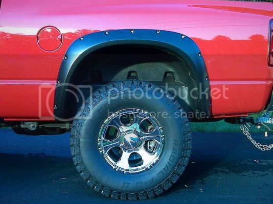

As far as gap guards, they look terrible. Go with a set of mopar wheel well liners. They look MUCH better.
Before-
After-

That is probably the most accurate description of installing a body lift I've ever heard and I agree on the mopar well liners. If you are gonna spend money on the gap guards, then just go and get you a rubber mat. I used one on my '98 Ram, cut to size and held in with pop rivets and some zip ties and at $20 it looked no different than the hundred dollar liners. The Mopar ones really do give it a nice, factory look...
