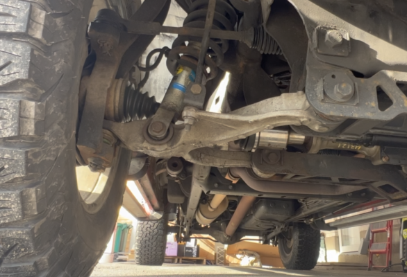

Not the greatest photos but they're the best I have right now before I run out the door. They're excerpts from a few videos I took yesterday of the suspension reacting to me turning the wheel back and forth and bounce the truck. I should also note that the tie rod ends are mevotech TTX's with about 3k on them and didn't show any signs of play. Maybe its the drivers inner tie rod though? I jacked it up and pulled back and forth at 9 + 3 and there was very minimal movement.
I've always found it strange how my CV's kind of angle up (the video angle makes it look worse than it is). The hub is about 1 1/2" higher than the diff, but I figured this isn't an issue since guys with a 2" level have more of an angle than this in the opposite direction.

Yes, that is odd that the shafts slope upward…never seen that before. Its usually level or the opposite…sloping down from the diff.
And yes, if the bils wernt installed correctly they will certainly make noise.

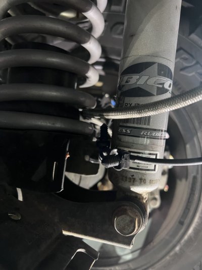

I have a Jeep Rubicon in my shop right now that drove fine until it went to an exhaust shop. “Imagine that” fast forward 15+ shops it makes it to me with $4k in brand new front end parts and a new steering box. And still drives like a blind turtle. So now I have to reverse engineer why every shop he went to sold him something else.
Sometimes firing new parts makes it harder to diagnose something simple. Then when it’s fixed dump a BDS lift under that truck.

Anyone that understands these steering systems the track bar and drag link should run parallel. How this went through multiple “Jeep specialists shops” like this and just sold more stuff makes zero sense. But my job is to make it ride like a Jeep that has 30k on it not figure out why people are dumb
View attachment 537665View attachment 537666
Started driving like **** when it left the exhaust shop? Did you figure out what was wrong?
Yes…definitely want the track bar and drag link parallel. Sometimes its tricky to “see” it because the track bars typically have bends in them. But yea, the straight lines between the two bolts should be parallel (which you obviously know haaaa). Did the lift kit on it have a drop pitman arm but no lowered track bar frame mount?
