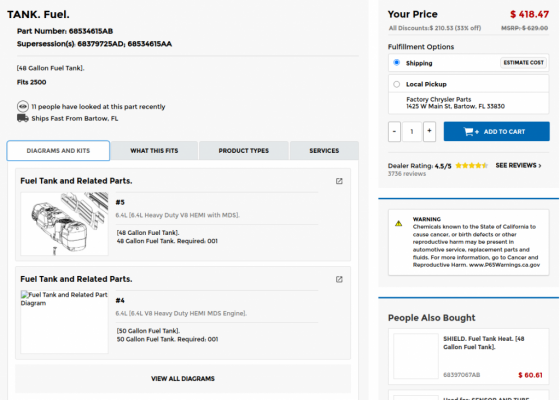

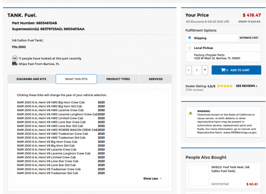

cdntrucker
Feb 24, 2022
Canada
6.4L Hemi
