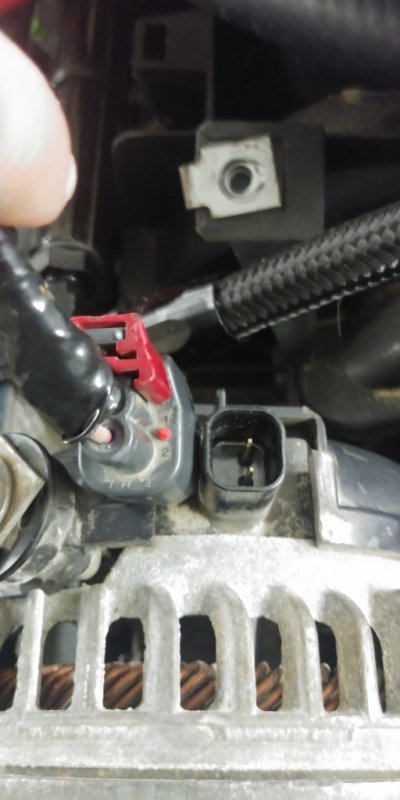

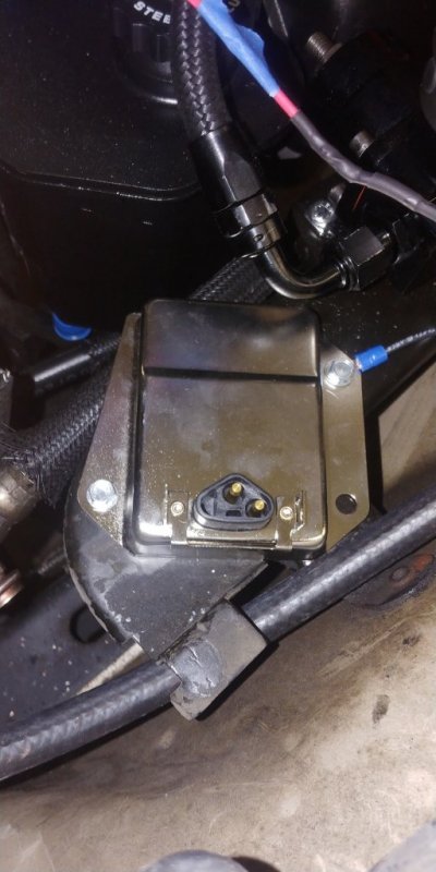

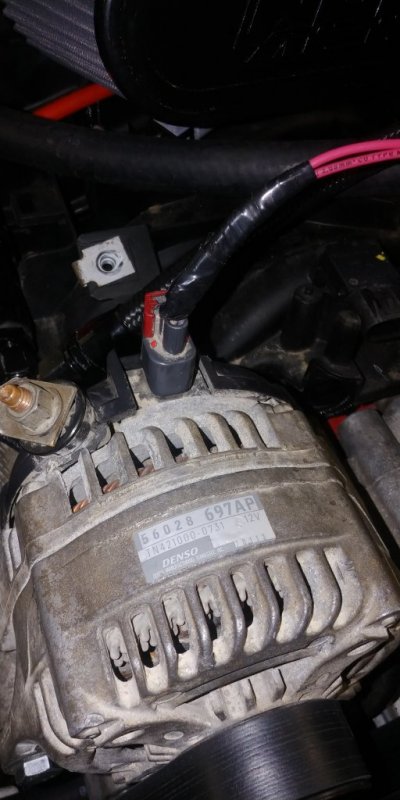

Can you show a picture of the regulator where the plug plus in and a shot of the actual plug?
2022-09-3022.22.402946964107205297995.jpg2022-09-3022.23.287108136992227000264.jpg2022-09-3022.24.08536284302749211112.jpg
Just took these. Green wire from connector is only connected to pin 2 on the alternator connector. Blue wire is connected to pin 1 on alternator connector and to keyed +12V. Continuity has been checked. I'll gladly take more photos. Thank you so much for your help. 2022-09-3022.27.49174647471751106382.jpg

Do you get no charge if the plug is off of the alternator?
Also check both pins on the alternator and see if one of them gives continuity between the pin and ground (alternator case).
"Started engine by jumping it
Removed ground jumper cable from jeep so that it's no longer getting power from donor car
Voltage kicks up to 17V
I then turned it off. I didn't get the chance to ground that wire that I had jumped from the connector. This is the exact same behavior as if I didn't wire the voltage regulatorup in the first place."
So if I am following correctly, you have + voltage going to one pin 1. Pin 2 is to the voltage regulator only. AND with the plug plugged onto the alternator but unplugged from the voltage regulator - you get 17 V. Correct??
That regulator controls the ground side of the field.
