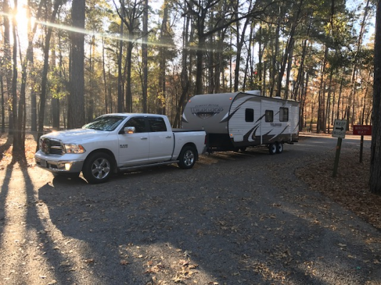

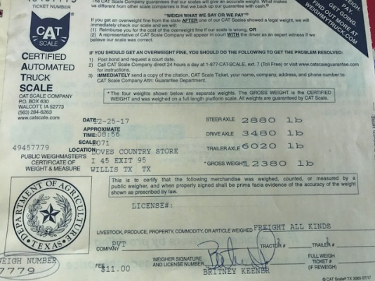

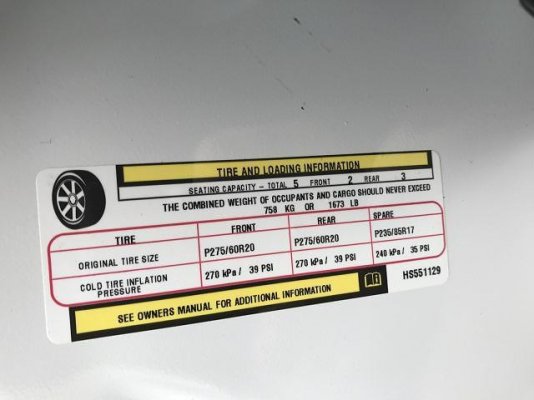

I bought our 2017 V6 1500 for my wife not intending to use it to tow our travel trailer (we do occasionally). It came with the 3.55 towing gear. We used to pull this trailer with a 2015 1500 5.7L 3.21 gear 4x2, but was at or slightly over the door sticker payload (1490). I was not happy with the way it handled, power was not an issue.
Its our first camper and we want a 5th wheel eventually, so I traded the 2015 for my 2016 2500 6.4L 4x4. Wife missed the cadillac ride of the 1500 so I traded her Wrangler Unlimited for the V6 Ram.
Of course, when I pull it with the 2500 its no sweat, but I gotta say this little 3.6L with same chassis as the 5.7L seems to handle it better! It lives in 5th gear mostly while towing and I won't win any races, but its very comfortable towing along a 65 mph at around 3k RPM. 440 lbs of payload to spare.

Props for the story and the pics. Especially the Cat scale pic and the white door jam axle & towing payload (GVWR) pic!
If you know what is your unloaded axle weights? And what hitch do you use?

Thanks! I wish we had more time to get the other two weights (truck by itself and trailer hooked up with no WD engaged) but it was Christmas.
I have two WD hitches, I use an Equalizer 4pt 1k (craigslist $120 score).
For the 2500 I use a fastway e2 1k round bar (and used it when I had the 2015 5.7 1500). This may explain why it tows so much better than the Hemi did. I suspect that I am over 1k on the tongue as the bars are very slightly bowed near the hitch head.
