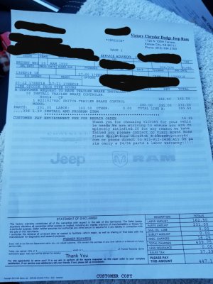

Joshua W Watson
Sep 20, 2018
Kansas City
Anyone get one installed yet? Curious how much they will charge for a $295 option.
My 2019 Bighorn had every option I wanted, but the trailer brake controller. So I talked the dealer into throwing it in.
Here's the service invoice, including part number, part and labor cost.
Nice. Thanks for posting. Not as bad as I was expecting. I thought someone on here mentioned a lot more.
