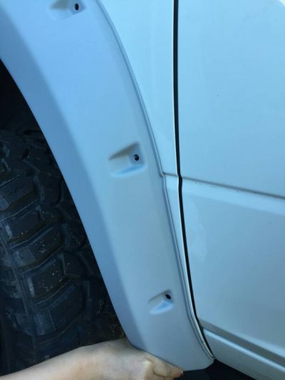

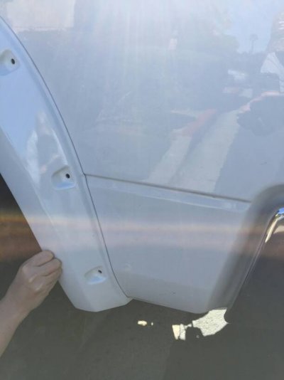

Here's some close ups of the ebay flares I posted further up.. They fit the body lines exactly, no gasket.
cd7a94d9a7dab1f3f0c7940f1b9a8604.jpg0a2df39f17186957f126d8f2880d9e4a.jpge02c80082c62f8517a2c20ac780ff27f.jpg
I'd like to see a comparison to the $600 bushwackers.
IMO
What brand are those, and how far do they stick out?

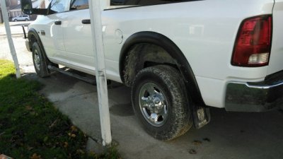

Here's some pics of mine. They are "stampede" brand oem style. I got them through my local Carquest. I liked the cleaner look of no rivets. They fit great with my aftermarket bumper and matched the body lines spot on. These have the rubber seal as well instead of tape. I haven't noticed any issues yet. What causes the damage people report isn't the seals themselves it's dirt and grit that gets trapped in there. Pressure washer blows that gunk right out. I'm sure eventually they'll show wear but by then the rest of the paint will have enough rock chips and such that I can just have the whole works redone again. :happy107:

Definitely residue and wear , where it hit my bumper there was wear through the paint, just a little , but a little too much. The rest was , as you stated , mostly residue from wax, dirt, etc. but a powerwasher wasn't doing it. Compound and clay worked , but it wasn't quick ...... If I did it again I would stay away from the rubber, or at least use a 3m clear underneath.

Trick is to use the pressure washer to keep it clean so it doesn't happen. Once it happens yeah, pressure washer isn't going to fix it. The truck can look clean as a whistle but that rubber seal will catch grit and trap it against the paint. That's where the marks come from. Keep it cleaned out, no problems :)
It is rather obnoxious to spend that much coin for flares to protect the paint only to have the flares ruin the paint. :word:
