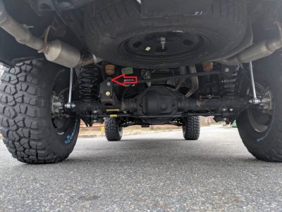

One thing I noticed is they put the panhard bar in the wrong hole at the bracket. They have it in the hole meant for the 3" coils. Since you have the 5" coils it goes into the top hole which will make it more parallel to the rear axle. You can look at the online instructions to verify.
Awesome, thanks man!! I wouldn't have caught that!! Will fix that asap! This is why I love this forum, so much knowledge here!

That's what's nice about the Zone or BDS, the adjustability allows you to go up or down, if you ever want go lower, simply adjust the bils to 0 or .7, add 3" coils and move that bar down to the lower notch.
