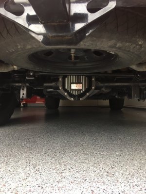

Finally got the Eaton Truetrac installed.
BacavilleHemi
Jul 18, 2018
46
83
Amarillo, Tx
2023 Dodge Ram 1500 Black Widow Edition
After waiting a year for Eaton to finally make the Truetrac for the 2015 Dodge Rams, I finally one got it installed. I ordered it from Jegs in December and got it January 20th.
All I can say is WOW. No more one wheel spin in the rain. Even with my 3.21 gears it grips and pulls hard.
The Truetrac worked so nice Thursday when we had frozen rain on the streets going to work in the Dallas area.
I wanted to get 3.92 gears, but 4wheelparts would have to order it and I didn't want to wait another week or so. Maybe another time, I'll get the 3.92 gears. My truck does more city driving than highway.
Glad I got it done. Worth every penny.
Truetrac - $507
Mag-hytec - $278
80W-90 gear oil - $38
Install+carrier bearing - $550
