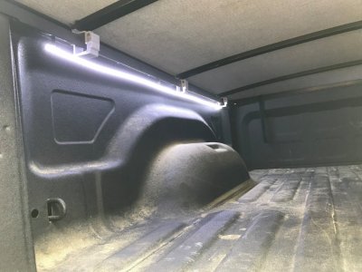

That's a good deal. Do you think it is bright enough for a camper topper?

They’re pretty bright. Lights up my bed with a black spray in liner. I was quite surprised how well they work.

Those look good. The Yitamotor lights are also adhesive backed.

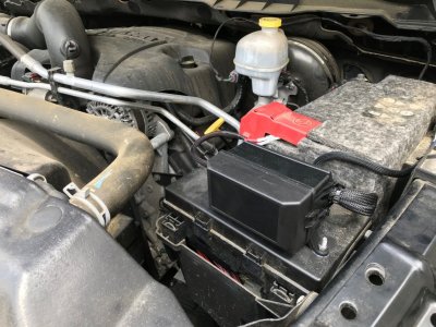

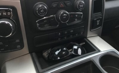

Looks great and gives you the light you need. Was your switch panel from 4th gen electronics a plug & play install ?

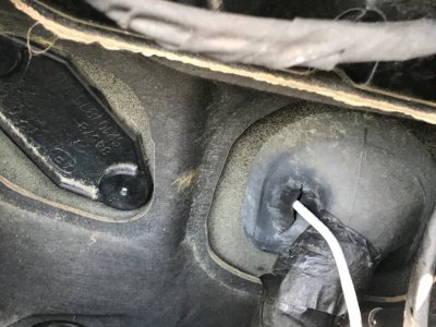

Thanks. The switch panel is plug and play, sort of. It comes with a relay box with relays, fuses and wires with slide connectors for each switch. You have to run the wires through the firewall and secure it inside the engine compartment. The instructions recommend using self tappers to connect it to the firewall but I mounted it to the top of the fuse box. Plenty of room. The hardest part was getting the wires through the firewall. I used a wooden skewer and some 550 cord. Other than that it was pretty easy to install. First 2 switches are hot all the time, the rest need the key.

Thank you sir, appreciate the information. I have and use a "wire insertion tool" for getting wires through rubber boots on firewalls. It has a hollow shaft with a kind of cutting end on it. Poke it through the rubber, and run the wire through the hollow handle, then remove the tool.
Awesome idea. The only problem I had was there were 2 seperate connectors that had to be pushed through the hole. I didn't want to dismantle them and make sure I got all the pins back in the right places.
