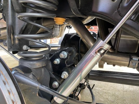

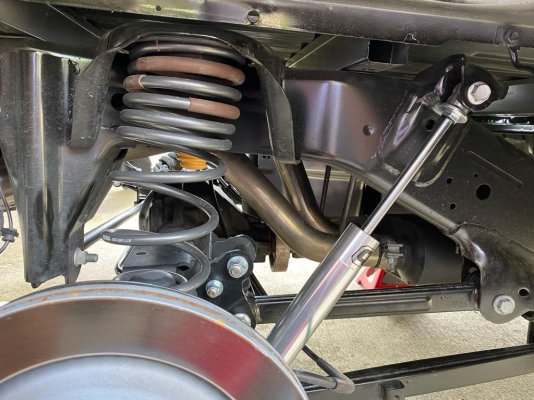

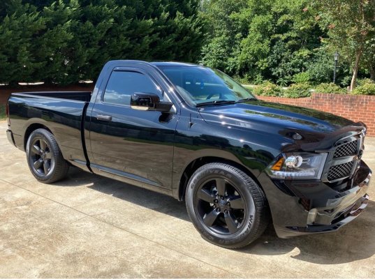

Adding some pics of my 2/4 lowered 19 Express.
Belltech 964 2/4 lowering kit
QA1 TS905 rear shocks
Belltech universal rear bumpstops
IHC no cut brackets
Originally didn’t cut rear bump stop cups. Kept hearing metal on metal in rear (surprise, surprise...not). Went back and cut cups, drilled and tapped holes for Belltech universal bump stops, and added QA1 rear shocks.
Alignment was able to be set to within spec and rides really nice now. Will probably add QA1 front shocks in the near future.

Nice

Looks great!

Ameldorf, Can you tell me how high your truck is now from the ground to the top of the roof? That is if you still have the stock tires and wheels on the truck. I want to lower mine so it will clear my garage door and need to know if the 2/4 drop will be enough.

Oh **** that's "purdy!"
QA-1's too, I'm so jealous.

Awesome looking.
Tell me about the no cut brackets. Difficulty for install, any issues or challenges
PITA, lol. You’ll need a plasma cutter, some good drills and bits, and patience. Can also drop the rear axle and do it that way. Totally worth it though.
