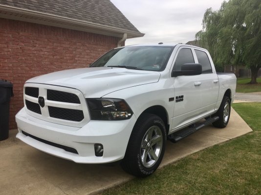

Finished the Blackout today

Got all my emblems switched over to match the black headlights and tinted fogs. Didn't take a pic but also added factory homelink overhead console! Hopefully next week I'll add the Flowmaster 50HD muffler. Haven't decided whether I'll keep the resonators or not yet. Pics as always!

How was lining up the new badges could u tell where they go once u got the old adhesive off?

Not bad at all. Get some blue painters tape, then just outline the old badges before you take them off. Used fishing line, got the old tape off, hit it with a little alcohol and then turtle wax adhesive remover and then a mostly water with a drop of dishwasher soap to prep. Then just line it up and stick the new ones on. They use some thick tape so it's pretty easy to get it off. Went pretty smoothly.

Ok sweet..thanks for the info pretty much did the same process removing the huge tailgate emblem

The black accents really make your paint job stand out!

Looking good! I really want to do it to mine, but am terrified I wouldn't get the black badges on straight.

I am a good example of just prep making the difference. I always seem to get things crooked etc, but I just went slow, took my time and was very specific with my tape outlines and I'm pleased with how it turned out. The two Ram heads even have locating pins so you can't really mess them up.
