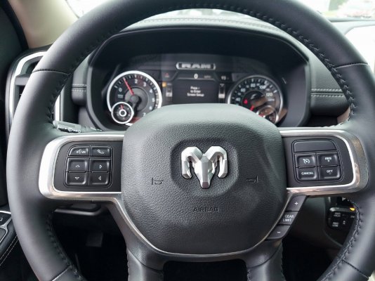

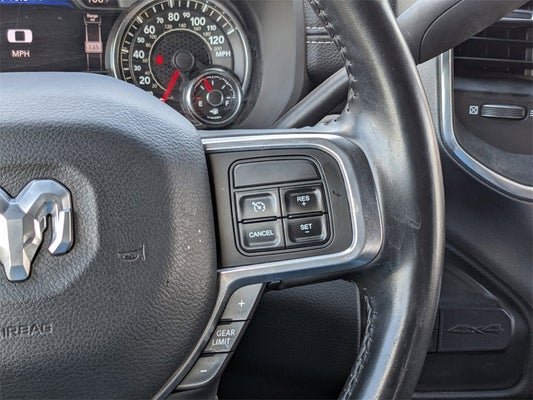

They are, but the steering wheel has the manual gear select buttons when you have the 8 speed. Look down and right from the horn, you'll see "gear limit" and the +/- buttons.
I would just like to add a clarification. The gear limit is not a manual gear selection. It only limits the top gear the truck will use. A manual mode would be more useful to me. The truck will still automatically shift between gears up to the top gear you specify.
