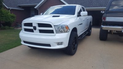

Post up some pics once you get it done! You can kind of see mine in this pic.
