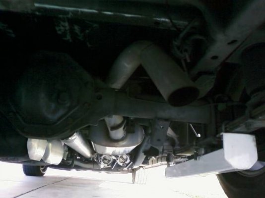

So sat I put a super 44 on. I like it but the wife hates how loud it is. I just have it dumped at cab. Now if I run some pipe to a 90 and have it exit the side will it help with drone and quiet it some.

Yes it will. My mustang had a pair of 40's dumped at the axle and it was waaay too loud for me. I clamped on a 18" piece of aliminized exhaust pipe temporarily which made the exhaust exit close to the bumper and it was much quieter.

Yes, getting the exhaust exiting out the side of the truck rather than dumping underneath it will definitely help get rid of some cab noise and drone.
When I put a Flowmaster system on my old 1500 I had left it dumping under the box for a day or so before I could get another hanger to finish off the job. Sounded terrible inside the cab (even with it under the box). As soon as I finished it off with the exhaust exiting out from under the truck it sounded much better.

Yeah I want to run it to after rear tire . I hope it takes some of the drone and loud away. My wife refuses to ride or drive it now. I just want a mellow hum .

I'm sayin, I agree, if you run a pipe away from under the truck, it should take away what you're hearing.

I'm going to put the rear resenagtor back on sew how that goes

So i put that on . And I like the sound it'd quiet till I get on it. And has a nice rumble .

move the dump from pre axle to post axle...it's like night and day how quiet it will be...
