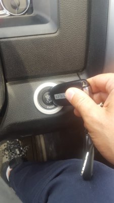

Hello guys,
I just found the easy way to get you going if you are stuck with "key fob not detected" and you have no spare fob or battery with you.
Firstly get inside your truck using the physical key hidden inside your fob, then simply press the start button with the black end of the fob itself. With or without the battery it works and at least you can get home.

Hello guys,

Worked perfectly! Thanks for the tip. Have a new fob being programmed tomorrow because I’ve been getting the “key fob not detected” message more and more often. Sure enough, I pressed the Start button with the tip of the fob and PRESTO, she started right up! Thanks!
