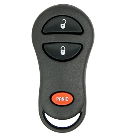

check this out, it is after market
but i think that a dealership would supply the same type of FOB
I called a local Mobile Locksmith to see IF they carried what i needed & also asked if they had the Programming Equipment
they had everything & it was 1/2 the cost of what the dealers price was
They had Locksmith Vans & also had a regular store
I used their store
