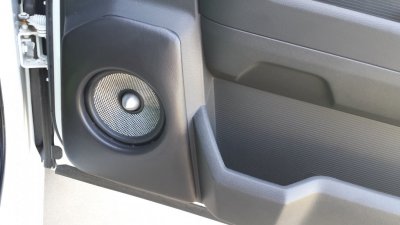

You can fit 6.75" easily...

As stated above, and your ears will thank you for it. :)
That looks really slick.... I have seen you post it before just never commented,
Do you have any pics of how you made that all come together?

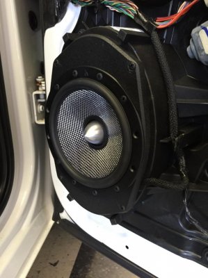

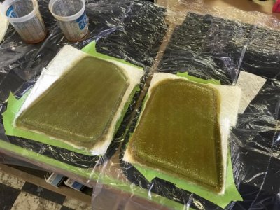

I will post a few, thank you BTW

Lol your lawyer was pretty convincing, but we settled on a new avatar instead of cash.
Im glad to hear that the 6.75 will fit! Did you make your own adapter or did you make it yourself? I'm tempted to take the adapter that Crutchfield sent me for the 6.5 Kickers and cutting the hole bigger

Do they have a place that you can work on personal projects? or is this your own shop?
The doors were made at our install guys old shop, they have a new one now, and we have an OEM install bay. So several luckily to choose form.
That dude took more than his 33%! :)
All custom, but I liked the way there was no more factory grill....Im sure you could do a 6.75" without all the extra build.
