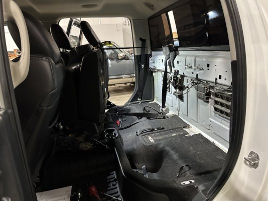

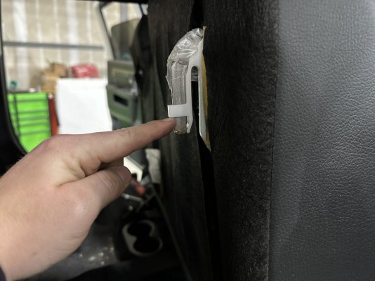

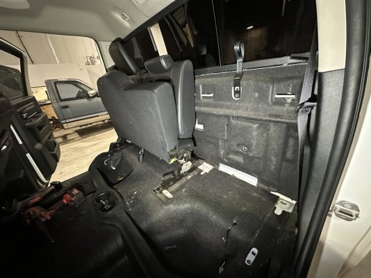

I literally just finished up this mod yesterday, I was chasing water leaks and did this while I was in there. You'll need to remove your fold flat floor and sub (if equipped) first, then remove the seat bolts. Once the bolts are out, just pull the seat up and forward to get it off to the hooks. I pulled the smaller driver's seat all the way out but the passenger I just moved it forward since I didn't want to bother with the seat belt. Once you've found the hooks, just trim them even with the bottom of the plastic piece and reassemble. Now your seat backs can fold down whenever you want just by raising the bottom up about halfway and pulling the seat back forward.
