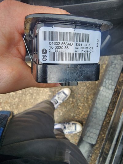

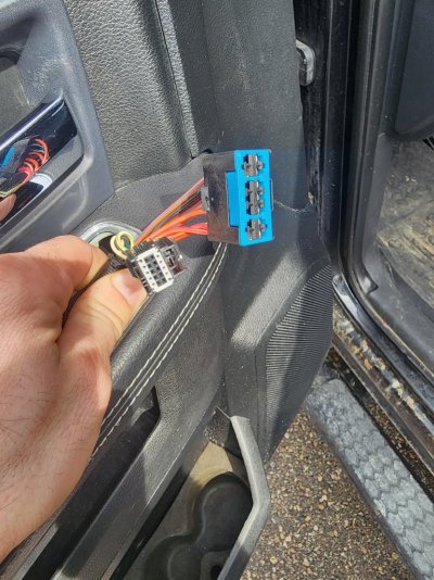

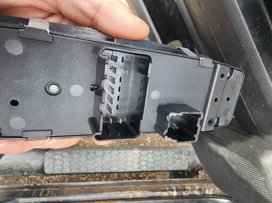

Hey guys
So I'm about to take a shot at installing some power folding mirrors on my 2009 Laramie.
I bought the same chrome non tow style power folding from a 2013 on market place.
I have alfa odb
Now my question is
Which driver control do i need ?
My truck has the 2 plug connection 9+3 pin control.
I have the 11pin control already but that can't work.
What do I do, can it be done ?
