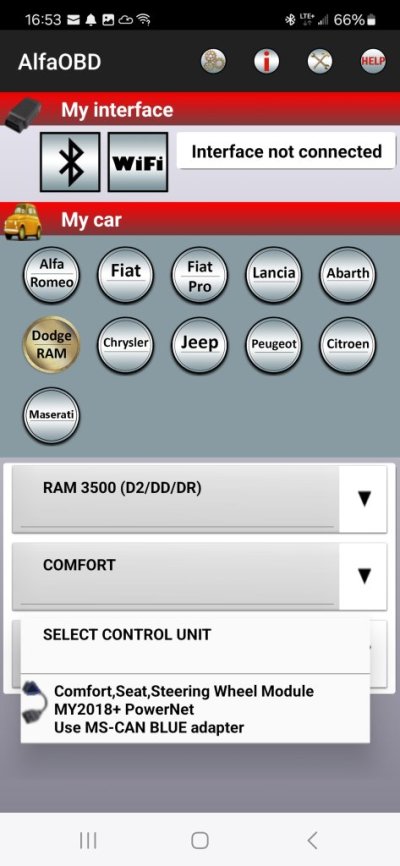

Well I just found more settings for the seat heaters that allows you to change the Celsius for each setting. No I haven't tried it, literally just found it.
It's under COMFORT.

Not sure I would use something that can't even spell temperature!! Haha
It's AlfaOBD. Well known here in the forum. I use it regularly without issue. I don't care if spelling isn't the developers strong suit. But I hear yah.

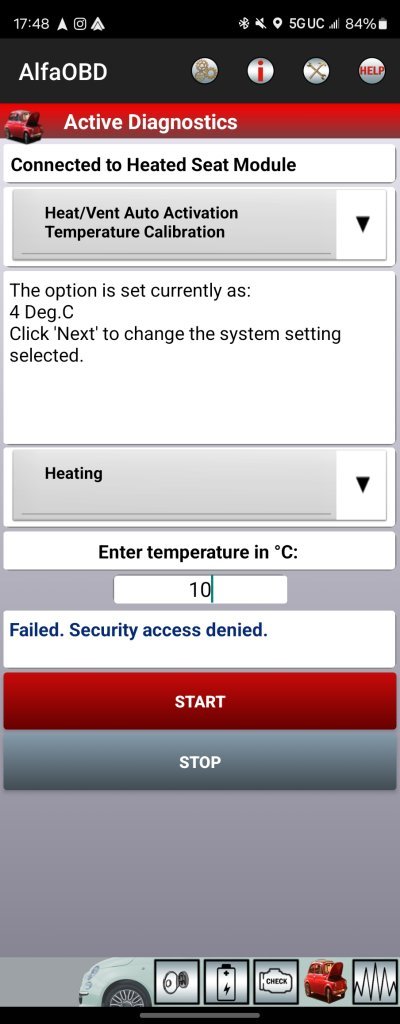

I found something very different in my 1500, but when I connected to the MY2018+ heated seat controller. But even with the KAoDTech bypass cable, I can't write to the controller. (I have written to a LOT of the rest of the truck, so I know the cable works for that stuff.)
