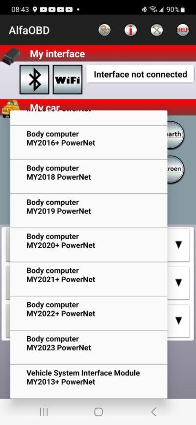

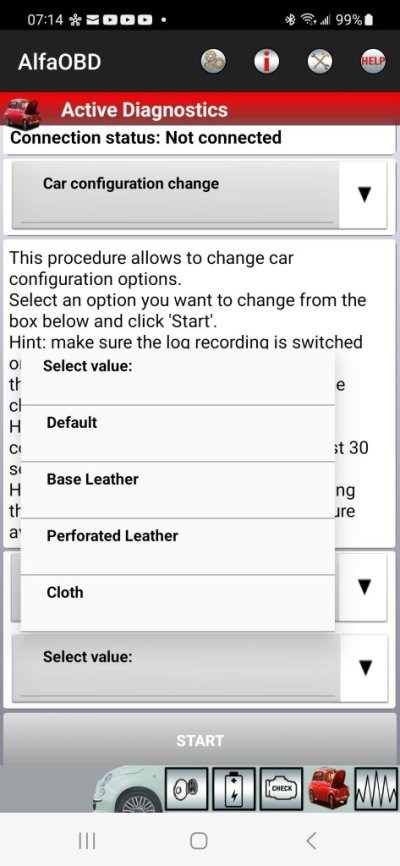

I wonder if they keep the temp down due to it being cloth?
Could always change it with AlfaOBD to see if it makes a difference but it may be a risk.

He has a 2023. You have a 2020. 3 year difference and Alfa has them listed as seperate BCMs so there is a good chance the modules from the factory are programmed differently.
That's interesting, mechanic I talked to yesterday said there was no settings adjustment available. I specifically asked about this as I'm likely going to get some Katskin leather installed. Thanks

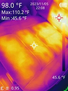

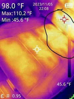

I left my doctor's office this morning, outside temperatures around 33 degrees, about a 12-minute drive home and when I got home, I ran in and got my thermal imager. Here are temperature pictures of the seat back and seat bottom after 12 minutes of three bars. Notice the temperatures running rounding around 110 to 113 degrees. The white cross mark is the big font in the upper left, the max temperature is the red cross mark.
As far as comfort versus heated seating, my build sheet is clear, they are listed as "Heated Front Seats" and "Heated Second Row Seats". The thermal images are defining.

Awesome, thank you! I need to get those pictures of my coils. But that is a great representation of what I would expect from this feature. And some useful ammunition in my fight
