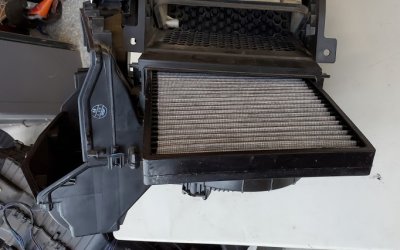

Just did this on my 2009 as I have the box out to replace the heater core and evaporator. You can see how dirty the evaporator is after 195,000 miles. I've seen worse. I got a K&N filter and the door off of Amazon. I recommend this update to anyone with one of these trucks as your A/C will suffer from the evaporator getting clogged up. I just used a box cutter with a new blade and it was easy. Of course a little more difficult if you're doing it in the truck but doesn't look too bad.
BTW, I work in the automotive industry and when cabin air filters first came out, the car companies started putting them in lots of vehicles. Then they stopped doing it so much because people would never change them. /then they'd bring their cars in for service for issues with the climate control. I bet most people still don't change them.
