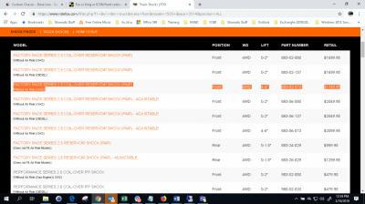

Fox 883-02-073 are 2.5 body adjustable coilovers Fox makes for BDS and they come preset for 6" as found by one of the forum members who has recently ordered them for his Zone 6" lift.
This was BDS release
http://bds-suspension.com/blog/?p=4260
BDS doesn't have an option for 2.5 body shocks rears, their only option is Fox 2.0's witout a reservoir which is the part number JB1 listed for you above. You can contact Fox with the specs i provided to you (30.05" extended, 18.45" compressed which is basically the specs Fox have on the 2.0 version they make for BDS 5-6" rear lift) and they can build a couple of longer rear shocks in 2.5 body with RES so you can match your front struts. Fox could even add DSC to the front/rear so you can fine tune your ride feel too. Call them to have the chat.

I think you got the numbers backwards. According to the website, 883-02-073 are the non adjustable where as 883-06-073 are the adjustable ones. But yeah I get what you mean.
So will the 883-02-073 be bolt on ready for my setup even though I don’t have bds? I keep seeing bds being brought up.
As for rears, is it model number 883-24-029 I would need to order but just modified (lengthened) to fit under a 6” lift?
Thanks!

Adjustable in this case doens't mean adjustable up/down in height, adjustable in this case case means the 883-060-73 have DSC so you can adjust compression valving with a knob , where as the 02-73 doesn't. :), both part numbers are for Coilovers, coilovers are adjustable via an adjusting collar that your turn up/down to adjust your coil assembly.
883-24-029 is the part number for ther 2.5 body rear shock for the RAM 1500 for 0-2" lift.
If you have 5" springs you want larger ones, so you can tell them you need a 2.5 body shock similar to what they did with Fox 883-24-029, but with 30" extension and whatever they deem they can compress the most with 2.5 body shafts. they specd out 30" extended and 18" compressed for the 2.0 they make for BDS part# 98224759, , so they should be ble to make something similar to that but in 2.5 body with res and DSC if you wanted that option.

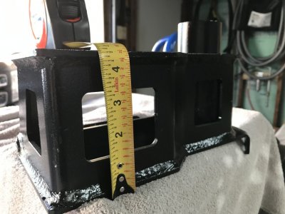

Oh if he is going all out, might as well ditch those rear 4.5” blocks and install the 5” BDS coils. I would ditch the weak oem rear control arms and panhard bar for the Core4x4 setup too. While your at it get the Hellwig sway bar and Core4x4 endlinks as well. I like spending other people’s money lol
@JB1 you had mentioned a few things earlier that I have quoted above but those things went over my head. I don’t mind going all out. So if my current setup has a spacer/block, what specific item and where do I order it to get those 5” coils?
I searched up core4x4 and looks like I’ll eventually replace those arms all around.
would those 5” coils be compatible with the RES 2.5” rear shocks I was looking at?
Lastly, it appears that hellwig sway bar only works for 2”-4” lift. So probably wouldn’t work for me.
Thanks in advance.

Procomp also makes a coilover for your truck you might consider.
Since your talking to a BDS shop tell them you want a quote on the 5” rear coil kit to replace your rear procomp 4.5” blocks. The sway bar kit you looked up includes end links, you only need the bar itself and you’ll reuse your procomp endlinks.
  1. Hellwig Rear Sway Bar P/N 7709
  2. BDS rear 5” coil kit P/N 022509
  3. Core4x4 use code “hot damn” for 5% off
Here’s your rear block spacer under your stock coils
