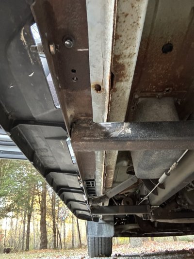

Lastly, To stiffen things up all it took was a short brace between the middle body mount bolt and the step.

Underneath money shots coming today.

None of it is painted yet.. and i need to grind those welds a bit more. But Im a solid 225 and I can stand on them all day, fore and aft.
