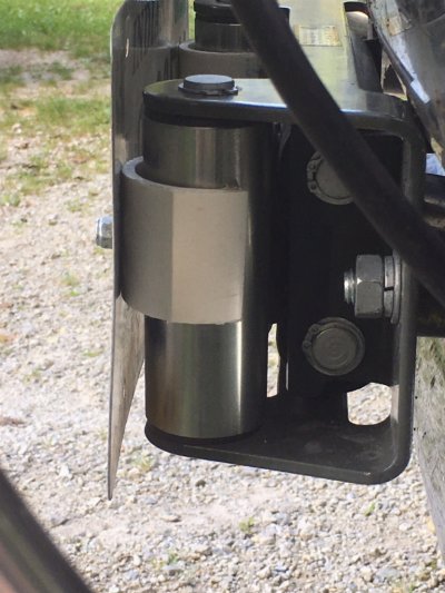

If you have a roller fairlead for the winch, you can make clips out of PVC pipe to hold a plate. b5bac0fa7ee0f1abeb89b0177a789c82.jpg

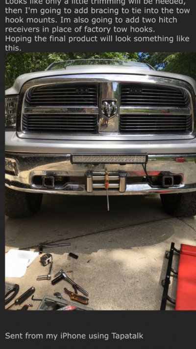

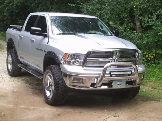

I actually thought about adding dual receivers to my winch mount. There is just enough room to fit receiver tubes through the tow hook openings.
But, I decided to go with the bull bar instead. 161a37f315f7c150e737a5dab6154836.jpg
If I could find that for a 1500, I would do it in a heartbeat, without hesitation. Two receivers would be as good as I could ever ask for.
