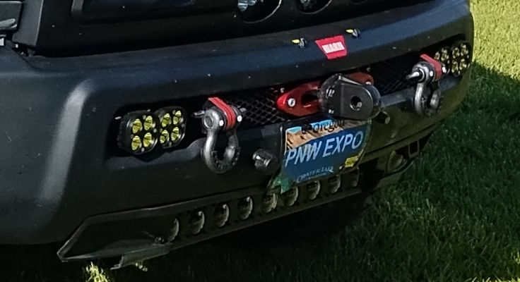

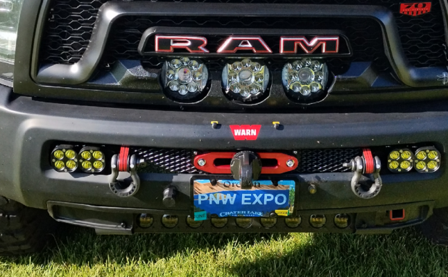

I mounted an Oracle Lighting Skid plate (for Jeep JL/JTs) on my 2016 Power Wagon. Just two holes in the supports that are behind the air dam (your 1500 might be different?)
A plus besides the added lighting (mine are yellow, so the 'down low' mounting really help with fog and dust) is the skid plate protects my steering box support (DOR unit).
Let me know if you would like better/clearing photos. The above are just cropped photos.

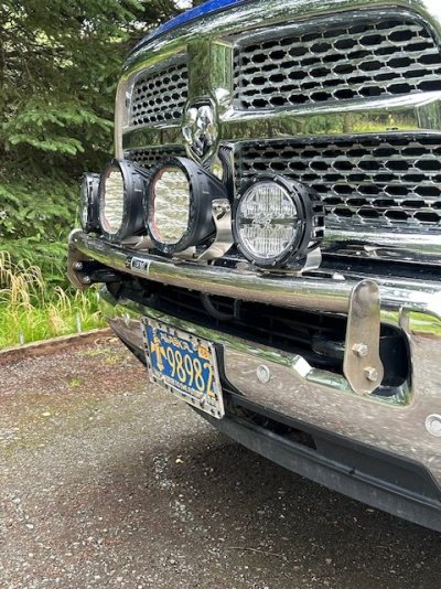

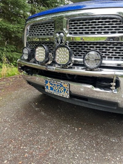

I have been happy with my Westin. It's stainless steel and mounts where the tow hooks are bolted in so no holes to drill. 7 years in the salt belt and still looks good. If you live in a climate where salt is used on the roads, anything else will start to rust within one year and look like crap within a few years, even the powder coated products in my experience.
I like individual lights versus a light bar so I can aim them where I want. I have the center lights aimed straight ahead and the outside lights aimed off to each side.

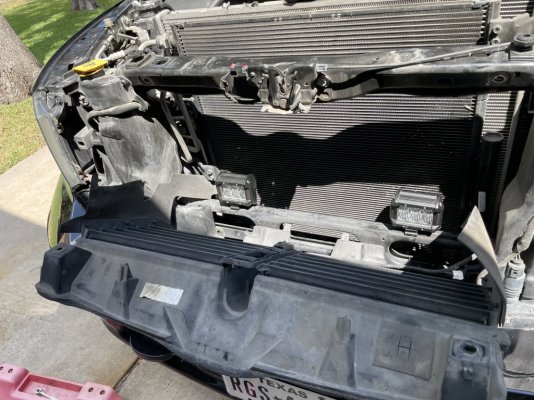

this is how i did mine.
