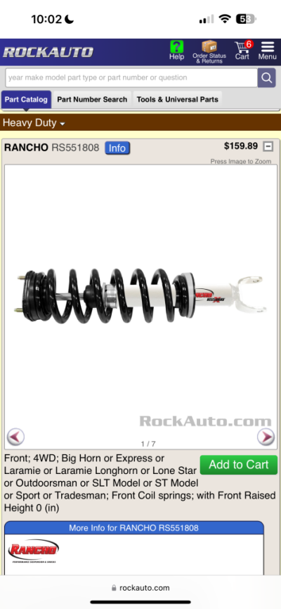

I was looking at Rancho strut assemblies just to be sure they’re beefy enough to handle it but if I don’t plan to add a winch, should I just go with the flow and not worry about it until it actually is an issue?

Id just put the bumper on and see how it handles it. If it seems to be too low or an issue, then change suspension.
And by the way if you have a leveling kit already and its the spacer kind, it is highly recommended to ditch that immediately and change out the struts with leveling ones.

Stay far away from Rancho. But yes a heavier strut would be in your best interests. You can build your own strut with heavier coils from cargomaxx, tufftruck etc, and bilstein 5100. Or you could do bilstein 6112 and set the preload higher. I just have stock coils and 5100s with a Steelcraft on mine, doesn’t ride great but it’s ok.

I get that you are looking at the rancho struts…what i am saying, is it sounds like you already have a leveling kit, and if you do and it is a spacer type leveling kit then ditch it for struts. Id be much more worried about those than adding 125 pounds of weight to the front bumper.
So just get good quality strut assemblies (other than Rancho) and be good to go?
