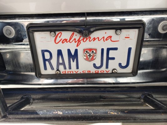

I have Crimestoppers CAM-300 camera in their license plate bracket.
Looking to do the same thing. Do you need a special harness or lock pick device to get it to work with the head unit or is it just plug and play?

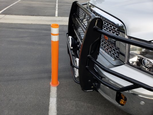

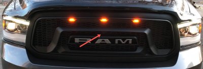

Based on your post I got the same one and it works great! I clipped the wires to turn off the lines. It comes with a numbers of mounts which I think makes its one of the better options out there. On the rebel style grille you can't really even see it when placed in the right location.
