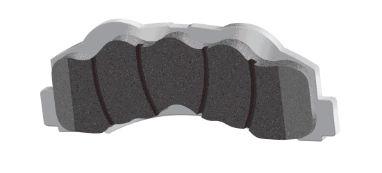

The number one squeaky brake pad is metallic or even semi metallic, the oem is metallic. I went to wagner oex and we have zero dust, zero squeak, and they stop better. Usually a high quality metalic will stop better then ceramic, but wagner oex will stop that truck way better then oem brakes, it was noticeable when we did our brakes in our suv. Demand wagner oex or put the job off until you can buy them. pads are 50 bucks a set of 2 on amazon. If the squeak is from the front, youn can easily save some money and just put oex on front rotors, front rotors do all the work when stopping, that is why they tend to be larger then rears. Wagner pads are like having 5 small pads, maybe that is why the stop so well, dunno? It also helps them cool, channels dissipate heat. Now, if you tow over 10k pounds, you might opt for power stop metallic, but if you dont tow or tow around 5k pounds, oex will simply be a great choice to avoid squeak.

See the bottom line in that graph, those pads are either causing the noise or contributing to it, if it is brake related which is most likely. I would say as long as your brake fluid is full and there arent any other symptoms, it is safe to put this off til you get a definite squeak that is easy to diagnose. A very large % of trucks have brake squeak, especially with oem rusty pads. peace

X2 on the Wagner oeX pads. Vehicle is the 1500, 4x4 2014. I have replaced the original pads with original pads. Then purchased the Wagner oeX pads for the front. The pads have been on for a little over 2 months. Great initial bite. I have the original rotors, they have never been turned. I am very easy on the brakes. Watch for yellow lights coming up and coast. No pedal pulsation. When I change pads, I scuff the rotors with 100 grit emery. The Wagner pads are the best I have have to date. I usually run Raybestos, which are good. These are VERY good. I like the high initial bite when the brake pedal is pushed. Your vehicle, your call on parts.
