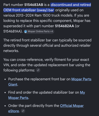

My front stabilizer bar on my 2013 Ram 5.7 4WD Tradesman has split on the ends so I copied the part number from the tag on the bar and I tried to find part number anywhere on the web but to no avail. It's 5154683AB but apparently that part number has been retired for a while. Is there a site somewhere that I can cross reference that part number so I can match it up and order another front stabilizer bar?

Have you tried looking up any of these numbers?
Thanks for the info... I've looked at all of the above part numbers so I'll go back to one of the Mopar sites and use my VIN and hopefully find the correct bar...
