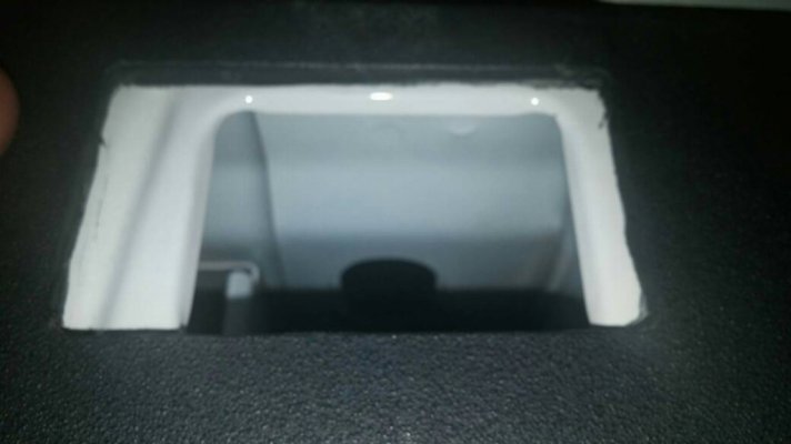

Hey guys, i went to open up my front stake body pockets this weekend. I thought they were just capped, but it appears the top bed rail covers are actually molded shut? There is an outline of where they are though.
Should i just cut them open with a utility knife? Or am i missing something? I see the opening on the rear ones are similarly outlined, but the actual holes are smaller than the outline.
Thoughts?
Thanks
G

basically yeas just cut them open.
Express SN95
Dec 16, 2012
303
108
Maryland
When I purchased my 2016 it had the chrome bed rails. Not being a fan of them I took them off. When I took them off it appears when it came from the factory they cut along the outline to open them up for the front of the bed rails. I would've had my old bed rail caps to sell but I wound up breaking the clips off of them when I installed the new caps.

Thanks much guys. That's so dumb they made the scribe line bigger than the actual holes. I thought they were smaller when i was poking around over the weekend.
I don't have a router and have no clue what bit he was using that would cut without scratching the paint?
I do have a dremel tool that i could probably use to cut that in a similar way, but I'm not sure about the bit. I'd probably scratch the paint.
Thoughts? Thanks guys.

Ok, it's a proprietary router bit with ball bearings on the end for a guide. That makes sense, Does not help me though. Lol!

BTW, you can buy the router bit from Bullring for $12.00. Or, you can call a local LINE-X dealer and ask if they will cut it for you. LINE-X dealers are exclusive Bullring reps (other than Amazon or buying direct from Bullring).

When I did mine, I used a box cutter, made a hole in the center of the outline and carefully, pushed through the plastic until I found the edge of the hole, with light pressure so I wouldn't cut into the paint. Then carefully cut along the edge in each direction. Took about a half an hour, the cuts weren't perfect but they are covered up by what was installed.

I cut mine out myself with a utility knife. Start at the center and work your way out; the marked pattern doesn't exactly match the hole below. Any imperfections can be covered up with the bull ring.

Ok , thanks guys. I don't want a bullring, i just want the holes open in case i want to use the upper tie down points. I guess I'll use a utility knife and maybe start off with a hole saw so i don't have to cut as much.

Just take your time and use light pressure to avoid hitting the paint under the plastic rail caps when you get to the edge.
