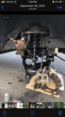

I Am a full time engine replacement technician and me and my fiancé both have rams hers is a 12 mine is a 14, we love these trucks and take care of them like they are my children, long story short I had to replace her front struts and lower control arms because the lower strut bolt snapped clean off inside and I did not want to deal with the headache of pressing new bushing in, so I bought factory struts and springs but I bought trq lower arms and now the truck hits bumps like the suspension is going to fall out and I don’t mean light wheel hop it’s very unsafe for my fiancé to be driving this way, my head is turning because everything is new and I want to blame the control arms being that the original is aluminum and the new are steel but at the end of the day I feel the shocks should be taking care of the impact when hitting bumps so maybe someone who knows what’s going wrong here? I can’t keep spending more money trying to fix this when everything is new

Got any pics of the new components installed?

Yeah the alignment was spot on and this has been going on a while, I left out some details, so In the picture that was autozone shocks and struts so it happend with those installed and I was told they are junk so I went out and bought stock factory and it still did it with 2 alignments neither made a difference then I had my Forman look and he said it has to be the shocks because that’s what’s not taking the hit of the pot holes but I’m not convinced being that they are factory new and before I did this work her truck drove amazing even when hitting bumps and now I’m buying a house so I have to get this right the next guess lol

Can you snap some more pics with everything installed? Maybe turn the wheel completely to one side and snap pics of the knuckles front and back? The more pics the better for sure.
Nothing is standing out as being completely wrong to me and I am sure you are completely capable of swapping these parts being an engine tech.
Got me stumped so far man.
Really nitpicking, it looks like you over torqued the front lower control arm bolt and squished the mount a bit (could just be the pic), and is that a jam nut on the LCA bolt? I don't remember that being there on my truck. How do the front sway bar end-links look?

Looks to like the upper balljoint is not in verticle alignment with the lower balljoint. Like the lower is leading the upper. I believe they should be the aligned vertically. Unless it is just the way the pic makes it look. If not then I wonder if those new lower A arms are the correct ones..
Yeah it’s the picture but trq might be on the ****** end not sure it’s the only thing left.
It’s just the picture and I switched it to the stock lock nut and endlinks came new in the kit
